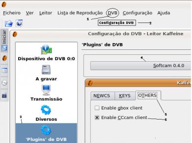

puis c la que sa ce complique tu doit installer une ancienne version de kaffeine avec qui le plugin kaffeine-sc fonctionne :
1) Install kaffeine 0.8.9 using the package. Deb attached Lucid already compatible with Ubuntu (just double cllick)
2) Install the plugin using the 0.4.2 package. Deb attached, in this case should go to the terminal when it forced overwrite
Then copy the. Deb in your home and run from terminal:
dpkg-i - force-overwrite / home/user/kaffeine-sc-plugin-0.4.2-svn_0.4.2-SVN-1_i386.deb
3) Create the folders:
cd / var
sudo mkdir etc
sudo mkdir bin
4) Copy to etc in the config cccam properly configured inside the bin to bin CCcam (use version 2.0.10, the above for me to go and chmod 755) and always in a bin file attachment ca.so course unpacked.
5) Start the flesh with the following command:
cd / var / bin
LD_PRELOAD =. / ca.so ./CCcam.x86-d
